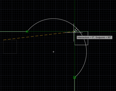

TheCADnoob
I'm having a hard time understanding the problem. One thing for certain is there is a lot of way to move things.
If i don understand the ask, the from command override can take X and Y coordinates. It default prompts to polar, but you can just enter a comma after your X value and it will revert to cartesian and then enter a Y.

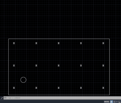

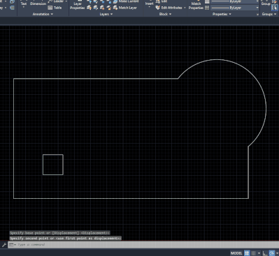

TheCADnoob
@RalphPaulozzo wrote:
.... do a "move, from, select where from, 10', enter" for both walls at the same time.
this can be done with from as is, assuming the walls come to a corner. this is also with the caveat that you have to type 10,10
There are a lot of good solutions on this thread. Which ones have you tried?
When you say type "from", i would start using the shortcut menu. with the move command engaged you can hold shft (or ctrl) and right click to get to from which could be quicker. In the example below i only touch the keyboard to press M, then ctrl, then i enter -10,-10.
If you don't have square walls or don't have walls that meet at a corner it could take some more but can be handled with object snap tracking. this can be seen in the second example.
Initiate the move command
Select the base point (NW corer... or what ever point needs to be 10 off the walls)
hold down shift (or cntrl) and right click and select from.
Select the corner where the wall meet
type in 10,10 and then enter. (in my example below i use -10,-10)
No corner wall
 added this image since its hard to see in video
