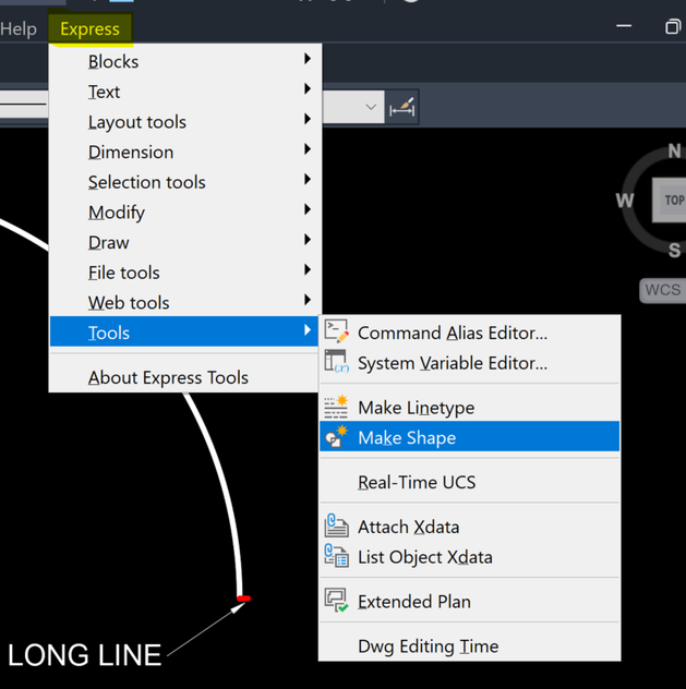

Can anyone help me make this type of line...I'm lost
894 Views
Kent1Cooper
That's certainly possible.  It looks like it should be fairly simple to do it with the MKSHAPE and MKLTYPE Express Tools -- investigate those.

As Kent suggested, please following the steps below to make a customized linetype:
1. Draw a half circle.
2. Make a SHAPE from the half circle.
3. Insert the shape with SHAPE command.
4. Draw a short line at each end of the shape.
5. Make a new linetype.
6. Select the shape and 2 lines. Pick up the start point and end point.
7. Change the linetype of the existing line or spline objects.
8. You can adjust the end segment length. Change the direction of the arcs by command REVERSE.
