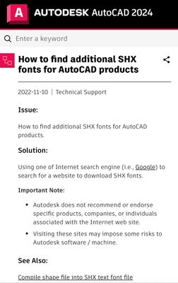

Hi @iialanji
The name of that font is ARCHTITL and there’s another font named ARCHITXT, the former for titles and the latter for notes.
You'll need to download those shx fonts (they not true tyoe) which you can find online using your favorite search engine.
BTW, the fonts you are interested in have gone out of style. There are nicer, more up to date ones >>HERE<<. Some are free.
