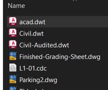

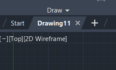

I see this thread is a few years old but the only result even close to my search...
New to AutoCAD and just started the 1st learning course. It looks like the files and "Step-by-step" visuals are from earlier versions?!
Is there a way to get the Drawing Tab to be the same as in the training videos and screen shots?  All I am getting are sequential numbers each time a new tab is opened, even with drag and drop of the "acad.dwt" file provided in the download.
File Tab only shows "Drawing#" :
Message 17 of 21
cadffm
Hi ,
1. Open a .DWT file is for editing a template.
   Your picture shows the acad.dwt, this is a standard Autocad template what should never edited!
    Instead for editing standard defaults, create your own one.
>>"it looks like the files and "Step-by-step" visuals are from earlier versions?!   "
Yes, the shape is different know.
>>"Is there a way to get the Drawing Tab to be the same as in the training videos and screen shots? "
The shape changed, you can not change it.
>>"All I am getting are sequential numbers each time a new tab is opened, "
Thats perfect!
You starting a new file (instead of your picture with an open .dwt file, ehich is for editing the template)
Drawing# is a temporary name for your new file, use SaveAs to save this new file fir the first time.
If you really want to EDIT a template(but please, not a standard  pre set template), you have to go this way:
Command OPEN, change the file extension to .DWT, choose your .dwt you want to open.
How to save a new  .dwt:
SaveAs, change FileExtension to .DWT
save your template .

cadffm
Please share the Link to this video/course
because the part with the "1." In front of is bad/wrong.
 Text is right and okay, but the picture with [acad.dwt] doesn't match the situation.
This is why you stumbled.
Drawing# is correct 👍

darin_alexander
Thank you for the explanation!
LINK:  Technical Drawing for Design and Drafting - Introduction to template creation | Autodesk
In the lesson an instructor shows how to use this file to create a clean new template file.
As mentioned originally, both Video and Screen shot Instructions show the "acad.dwt" tab but I could not get the tab name to match by following the instructions of "open a new" or "use the provided template file" with drag and drop.  Use of "Open File" and browsing to the provided template "acad.dwt" was the only way I found to have the tab finally show the name as the lesson portrays.
