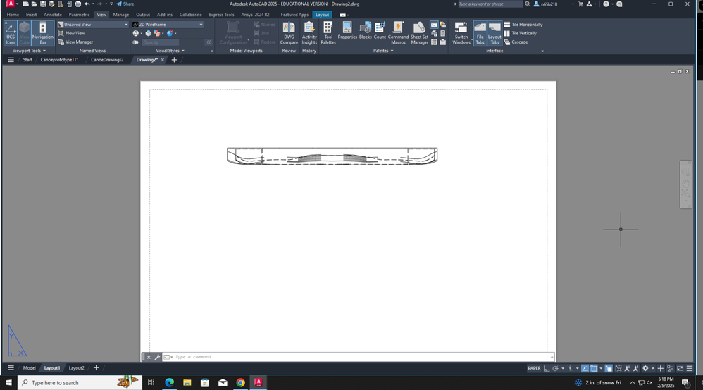

lines on my 3d model in the layout tab that I do not want to be there
n65b218
298 Views
n65b218
Screenshot (4).pngScreenshot (5).png I want to get rid of the lines in the center of my 3D model. They keep showing up in the layout tab and I do not want them to. To clarify I am talking about the wavy lines you can see on the model and in the layout tab. I have tried to change it to only visual lines and they are still there. I have also tried to modify the visual style and nothing I can find helps get rid of these lines. This model was made with the loft command between different cross sections if that helps. I have attached the AUTOCAD file if you want to take a look for yourself.
299 Views
VincentSheehan
How about the visual style Realistic or Shaded? Or would you like to see the outer lines?
Vincent Sheehan
Sr. Civil Designer
Poly In 3D Blog
Valentin_CAD
@n65b218 ,
Try the following setting:
Emilio Valentin
n65b218
This fixes the issue in the model space but does not fix it in the paper space. My main concern is the paper space. If you know how to fix that that would be amazing thank you.
