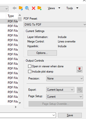

I do the following to create a PDF:
Export> PDF
Then these are my settings:

Check out this Autodesk knowledge network article. They make adjustments in two places in addition to having much higher DPI settings
https://knowledge.autodesk.com/support/autocad/troubleshooting/caas/sfdcarticles/sfdcarticles/How-to...
