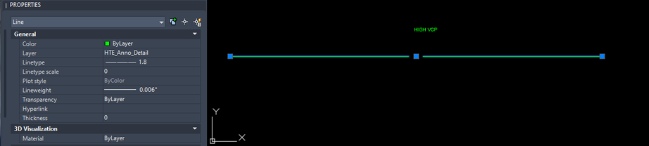

I have created a line type that includes text, however I cannot get the text to show as the size I want it. If I select the line and go to properties > line type scale I can only change the scale to 0.1 to get the text to show and it is not at the correct size. If I change the scale to anything other than 0.1 the text does not show
 If I go to Line Type Manager and change the Global and Current scale factors I can get the text to the height I want it but this changes the Global/Current scale for every line type in the drawing. Is there anyway round this?

Please see attached. Thank you!
paullimapa
please attach the missing shape files:
your linetype defintion:
*1.8,1.8
A,8003.537097,-103.191052,[1.8,C:\Users\Enna Wall\Desktop\Drawing5,y=-47.644981,s=1],-389.655064
