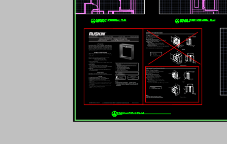

Having an issue with my layout colors I am using AutoCAD 2015
My layout color preferences show correctly in most documents, like this:
In One of my drawings, this is what the layouts look like with the same options settings.

OK, I purged essentially everything out of the file, since I wouldn't want to distribute the architect's work without their permission, I also hoped that doing that and then auditing might have resolved the issue.
Note in the file that the paper background is CYAN, but that only seems to affect the paper shadow and those horizontal lines (which do not appear to be objects)
Hopefully this file will show that the issue is isolated to the paper background element in the sheet/layout context,

No aplicable
Just when I was ready to assume it was the file... mine looks like this. the paper border and those lines that extend to the sides are the only things that change when changing the color of the paper background

An update,
As I was working on this drawing, I noticed another display issue Note the different displays of the same block.
Just popping this up there to see if it triggers anyones memory about perhaps how fills are displayed/plotted
This is the case for all of my blocks that have filled regions

Solución aceptada
Hi @Anonymous,
Try setting FILLMODE=1 and let me know if this corrects the issue.
John Vellek
No aplicable
MY HERO,
That was it!!!!!
Tried to see if I could click kudo more than once for this one. My eyes (and drawings) are saved!
Thanks for sticking with me on this!
(in case anyone reads this in the future, entered the command in paper space, and the main background updated as soon as I zoomed, to get it to fix my blocks in paper space I had to REGENALL, and that did it)
