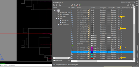

I have a drawing in which I have used another dwg file as an Xref. I have 10 layouts or sheets from which I want to create the PDF. When I select all the 10 layouts and give publish command some layers of the Xref file does not plot. But when I print individual layout by CTRL+P everything prints fine (all the 10 layouts). I have tried a lot of layers and page setup solutions but nothing works. Can anyone help me with this weird issue?

I am not finding any difference when I publish or when plotting individual layouts. Check the attachment I have included the published PDF and individual layout PDF as well.
I assume that you are talking about the few layers which are set to no plot and these layers will not be plotted to PDF.
See screenshot. Try to set it to plot so that those layers are also plotted in PDF🙂

Are you using your specific plotter? Because I am printing using XYZ-2017.ctb (which is included in the zip file). I tried again and the result is the same. Also, I do not need the layers which are set to no plot. I have attached the pdf for my printing results using the same ctb setting.
