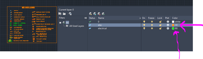

I copied a legend of electrical symbols from another drawing and when changing the associated layer color, in time it always seems to snap back to its original color. Any ideas what could be causing this?

Here is a dwg of the legend that contains the 'elec' layer, which in my current drawing keeps snapping back to color 152. I have not noticed exactly when this happens, but I still need to manually change it most times I publish to PDF. The legend was simply pasted from another file, not inserted as a dwg reference.
