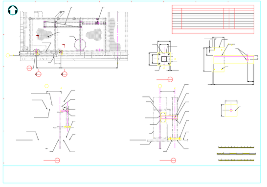

I have a mysterious issue with some of the drawings when creating a PDF from a Layout using PDF Maker in Autocad 2014 or 2018.
Attached are a sample of a couple of the files to see if you get the same issue?
Also, do get inconsistencies as well with the results.

Do you mean the missing content that is drawn on layer 0 in the block X_PANEL_RELOC?
No problem here when I change your plot style table to MONOCHROME.CTB, so your issue is likely there unless you like the other fella here turned off layer 0 for some reason. See attached.

I have noticed that if I open the drawing and PDF it straight away images are missing in the view ports in paperspace.

I see indeed issues with these drawings. The *1.pdf files are missing viewport information.
I notice that the viewports are clipped on a polyline with exact the same size. I don't see the purpose of clipping here, but this seems to be an issue at the 001-91223-01 - Copy.dwg. When I remove the clip the viewport prints well (see 001-91223-01 - Copy-2.pdf).
With the other drawing (001-91225-01 - Copy.dwg) the content of some vports are not shown . Here it seems to be an issue that the layer VPORTS is frozen. When I thaw that layer and place it on not-plot the viewports are show .
and not Frozen and we have never any issues.

Can you clarify how to determine the clipped viewport and how to fix it.
As for the other drawing I set the VPORTS layer as follows.
Display ON, Thawed, Unlocked, No Plot and typed PDF to create. The Viewport and the images inside it are shown in the PDF using PDFMaker.
Display OFF, Thawed, Unlocked, No Plot and typed PDF to create. The Viewport is not shown and the images inside it are shown in the PDF using PDFMaker.
