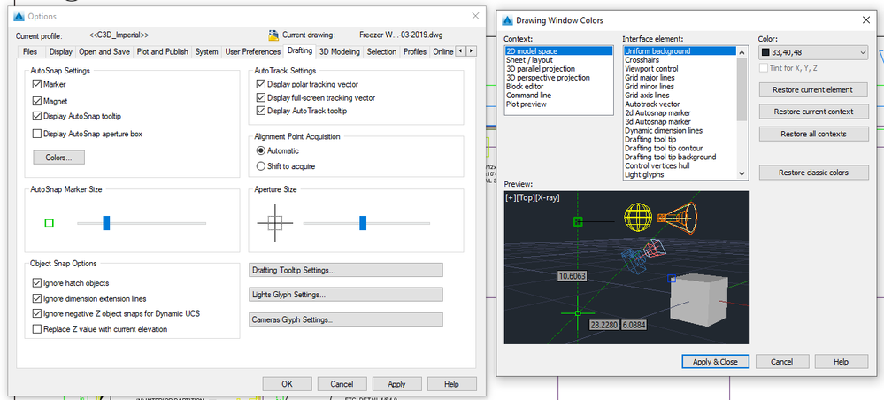

Is there a way to create an inverse plot style of the standard Grayscale.ctb plot style, where lighter colors print more black and the darker colors print more gray on white paper?
I am currently using the standard 'dark' uniform background when drafting in model space (Color 33, 40, 48). It seems to be easier on the eyes to look at a darker background and brighter line types and also helps to quickly identify contrasting layers while drafting as the different colors and line types pop more against a dark background.
To make it easier to visualize how my pages will look once printed/in paper space, I am using brighter high contrast colors for layers that need high contrast (dark when printed on white paper) and darker colors for layers that i would like to blend into the background/have less contrast (varying shades of gray when printed on white paper).

Hi @Anonymous,
I'm not aware if there's a quick way to create an inverted grayscale plot style. However, I do know that you can modify your plotstyle to suit your requirement. You can either change the screening section or change the color to a specific shade of gray. See attached and hope this helps.
If this resolves your issue, please click ACCEPT AS SOLUTION to enhance the forum.
Yea, it was taking too much time to search for a quick solution. I ended up doing what you had posted shortly after posting this so i could get things printed later that day. I selected each color and changed the properties in the "plot style table editor" basing the middle axis. It took about 15-20 min to modify most all 255 "Index Colors" to be various shades of gray. Its not perfect and may need some tweaking eventually but it worked for now.
