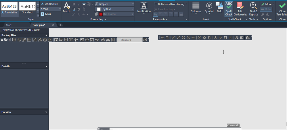

im working on an assignment and every time i insert a table, the table and my floor plan disappear. when i exit "text editor" the floor plan and table reappear but theres no way for me to add text when this is happening and im not sure whats wrong. table.pngtable 3.pngtable 2.png

Thanks for your file.
Let's talk about all of your rookie mistakes so you can start avoiding them in the future:
  1. Why is your modelspace not drawn at 1:1 scale? or is it not supposed to be units=inches, but something else? A typical door in your plan is over 827 inches in width (that is 68-feet wide).
  2. Are you assuming the table STANDARD is already pre-set and pre-defines for you to use? All the text in your plan is drawn at 200-inches high (over 16.5 feet) but your tablestyle has your text size set at well under one inch (0.18 to be precise).
  3. Your columns/rows settings of 6 and 8 are not going to be very big in the giant not-correctly-scales floor plan.
Looks to me like you need to start over: what is your intended units, inches or mm, cm, meter, feet or something else? Then scale your drawing correctly to 1:1 in modelspace. Then we can revisit your TABLE settings as defined with TABLESTYLE command.

Reach out to your instructor for additional guidance then: playing the blame-game is not how it is done, something got missed by them or you and it needs to get corrected.
Read #2 and #3 in my last reply on how to fake-it to match your out-of-scale drawing in the interim.
