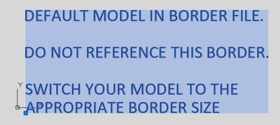

Hello, my company has switched from Microstation to AutoCAD and I have some old .dgn files that I'm having trouble opening in AutoCAD. When I try to import the .dgn file it imports the following text block. I am unsure what it means by "SWITCH YOUR MODEL TO THE APPROPRIATE BORDER SIZE" and AutoCAD's help menu has yielded no results. Any suggestions?

If you start a new dwg file .. any changes ? OR you may need to check the DGN version .

I started from a new dwg file, no changes. Unfortunately I can't open the dgn version since I no longer have access to Microstation. Any other suggestions?

Thanks for the file: I had no issues at all with DGNIMPORT in AutoCAD 2021.1.1 once I completed the import pop-up settings based on my expectations. See attached.
