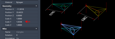

You can scale blocks in one, two, or three dimensions independently. Arcs and circles can only be scaled uniformly.
Create a block of the triangles and then determine the scale factor for the scaling.  FOr the following it was 1.03358522 in Y.
lee.minardi
jetted4
That looks like does exactly what I needed.  Thanks  🙂
