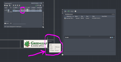

pendean
Community Legend
Community Legend
@aduncanE8VUL wrote:
no notification--I added the logo by opening it in paint and selecting it and doing pastespec to insert
AutoCAD seems to think you should be able to select it, see the pop-up
Share that DWG file here please.

aduncanE8VUL
I see that says frozen I don't know why because when I opened it up this morning it does not say frozen and I still can't select it.  the pop up shows up when you hover.
