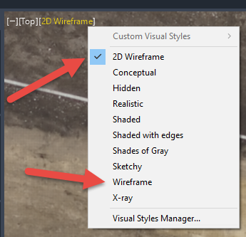

Apologies if this has been answered before but I can't articulate my problem well.
Every time I select an item like a dim, for example, the X/Y coordinate symbol appears in the centre of the dim. How do I switch this off?

If you go to options -> 3D modeling, make sure the viewport controls are displayed
Then make sure you are on the '2D Wireframe' visual style and not on 'Wireframe'

Try commands "GTAUTO=0" and "DEFAULTGIZMO=3"
