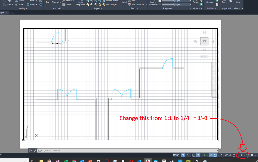

First time posting in this forum. New user to AutoCAD, having a great time drawing rather than paying other to do it now. Though I have a issue, where there seems to be no clear answer on google.
I am trying to print on 11x17 to scale. I am making a plan set for my local city, and they need it to be 1/4 = 1'.
For the life of me, I can not figure out how to make this happen. I have followed lots of tutorials and still no luck. Closest I have gotten so far is getting everything to double scale. If I  have an 8ft wall, it is coming out to 16...
Please, if this has already been posted or answered my apologies, but again, beating my head against the desk here.

ChicagoLooper
Try this:
Change your viewport scale to 1/4" = 1'-0".
Viewport scale.Viewport scale.
Then change the 'Page Setup Manger AND the Plot Dialog Window so they look like this.
Make your page setup and plot dialog like this.Make your page setup and plot dialog like this.
Chicagolooper
