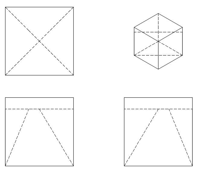

I have gone around and around in circles trying to come up with a satisfactory solution for obtaining a high quality (vector, NOT raster) plot in a hidden style that will respect line weight. Basically, I can get the layout to look great in paper space, but I cannot generate a plot of what is on the screen.
I believe I am familiar with most, if not all of the plot styles and options, so please try not to insult me by asking if I have looked in my CTB file, or if I have checked the 'Plot object lineweights' box under the 'Plot options' of the 'Plot...' dialog, or what the 'Visual style' or 'Shade plot' settings of my viewport are, etc. etc. etc. ad nausea.
For testing purposes, I have a large matrix of objects in various combinations of Layer, ByLayer, and ByBlock. The test objects are composed of a line and some text contained inside a surface. These are externally referenced into model space in another file, and marked up with a revision cloud in paper space for test plotting. As an example, here's what I see on the screen in a layout tab:
Desired PlotDesired Plot
Yet when I plot 'Hidden' 'As Displayed' (or anything else that I have tried), I get something like this (or worse);
Obtained PlotObtained Plot
Does anyone have a secret that I'm not seeing? Or should I keep looking for new software?

Hello Paul,
Thanks for your note. However, I am not having difficulty with visualizing the lines, I am having difficulty getting them to plot. It looks to me that during plot production something mysterious is outright changing the line type used to depict the hidden lines. Maybe the edge settings are taking over the obscured edge settings, or the view is reverting to wire frame, or WTF?!?! Any ideas?

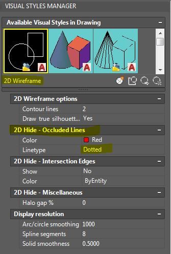

Thanks for looking into this. I think I may have stumbled onto something. It seems that in some instances plot production can (at least in part) be corrupted by the 2D Wireframe Visual Style. For example, I have a layout set to plot 'Hidden - As Displayed' according to the following Visual Style:
LayoutLayout
At the same time, my 2D Wireframe Visual Settings are as follows:
2D Wireframe Visual Style2D Wireframe Visual Style
I plot according to the following settings:
Plot SettingsPlot Settings
I get this:
PlotPlot
So it looks like at least one 2D Wireframe parameter is overriding the Hidden plot process. Needless to say, this behavior is not to be expected by the User! Now the question is, what other instances of cross contamination are going on?

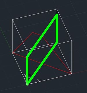

To elaborate on what I briefly mentioned in my earlier post about the approaches that I think come closest to getting the desired results, but still fall short one way or the other, here is an example of plotting a View Port with a (tweaked) Hidden Visual Style As Displayed, versus plotting the same model with View Base. The model for this example consists of two surfaces of differing line weight, both contained within a cube. One surface is rectangular and thick, the other is trapezoidal and thin.
Example ModelExample Model
I create some View Ports, set the Visual Style to Hidden, the Shade Plot to As Displayed, and then play around with the visual style settings to get what I want. The display shows obscured objects true to their line weight, but with a dashed line type. Perfect.
View Port Display, Associated Visual Style, & Shade Plot SettingsView Port Display, Associated Visual Style, & Shade Plot Settings
Now I try to plot according to the following settings.
View Port Plot SettingsView Port Plot Settings
I get this instead. Bummer. However, we are on the right track, in that line weight information is coming through, and we are trying to show the dashed lines.
View Port PlotView Port Plot

Try, in visualizations 2D Wireframe, 2D Hide-Occluded Lines, Linetype: Long Dash, and set color to white. Then select the Paper Space viewport, then in properties, plot as hidden. And, be sure inside each viewport that it is set to hidden. It worked for me.
