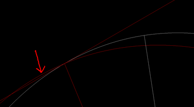

Message 16 of 17
dany_rochefort
@leeminardi i'm pretty sure my method is correct. Had you checked the link i provided you would of saw the rest of the procedure.
Message 17 of 17
leeminardi
@dany_rochefort   The process you outline for determining an ellipse is correct for finding the intersection of a cylinder and a flat plane but that is not the full task here.  You need to take it one step further and determine the projection of an ellipse that is not parallel to any of the principal planes and then project it to the viewing plane for an isometric drawing.
An ellipse on a plane skewed in space will not have its axes oriented the same as the ellipse project to the viewing plane.  The red line show the axes of the ellipse on the incline plane while the white line are of the ellipse that is projected to the viewing plane.
In the images below your ellipse is the red one while the correct ellipse is in white.
Note how the red ellipse is not tangent to the midpoint nor within  the parallelogram containing the ellipse while the white ellipse is.
