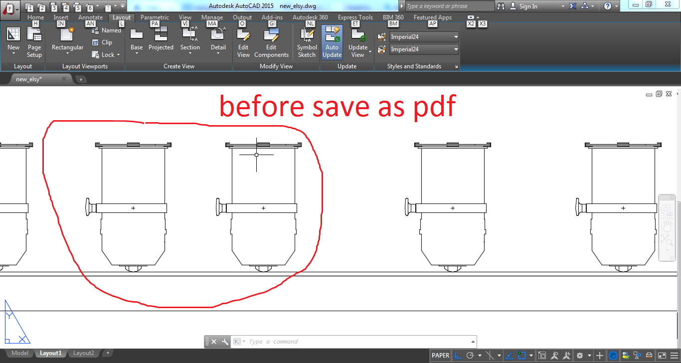

hello there, could you help me, to fix this trouble ?
i make this
but when i try to save as pdf (plotting) i get this, the line was broken :cara_de_decepción:

First things first. Check to make sure all those objects are on a layer that will plot. If the layer's printer icon has a red line through it, it will not plot.
Second. Try just plotting one of those objects. Does it plot ok?
Third. If possible attach the drawing here so we can have a look at it.

first is done, all layer will plotting, not red icon printing in layer
second, also done when i plot an object and plotting as pdf, the line in this case lamp object not broken,
-- but when i reduce  lamp object size and try to plotting again as pdf, i get this trouble as you can see in my post the line was broken
-- i try command REGEN but it doesn't work.
third that file was attached, could you give me solution :cara_de_decepción:

Ok here's the problem. Your lighting rig is too small.
As you can see in the attached PDF I had to blow your lighting rig up a lot to get it to show.
Here is what you need to do.
On your first drawing where you want the lighting rigs to go put a line and some legend eg LR1 (Lighting Rig 1).
Then in a new drawing. Draw the lighting rigs bigger. I was going to suggest a table, but that won't work since some of your lighting spans across parts of the fittings.

Ok thx bro, but how if in this case i wanna my rig still small like this? reduce without broken line in my rig

You can't. You need to do as I suggested and draw your rigs on a new page at a larger scale.

Increase the PDF resolution until you see all the all the necessary detail in the "lamps"

While I agree with that as being probably the best way to go. The downside is it will ramp up the PDF size massively.

Surprisingly, I used AutoCAD2016 to create the 4800 DPI PDF attached in my previous post and it's only 32KB.

Probably due to something in the software recognising that something which is white does not need any information.

Done !!,  hehe
