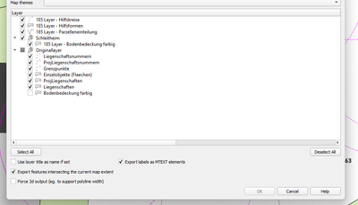

I am not sure what you mean by "maintain projection" because Qgis-dxf exports the drawing from model space. The projection is exported as it is shown on the screen.
Another tip which might help you: If you have conditional coloring of a layer like this
then you can change a property while exporting to maintain the color codes. In the export dialog scroll to right
And change the "Output Layer Attribute" to the Attribute which your colors are assigned to
Then you have the same layers in your DWG as in Qgis
