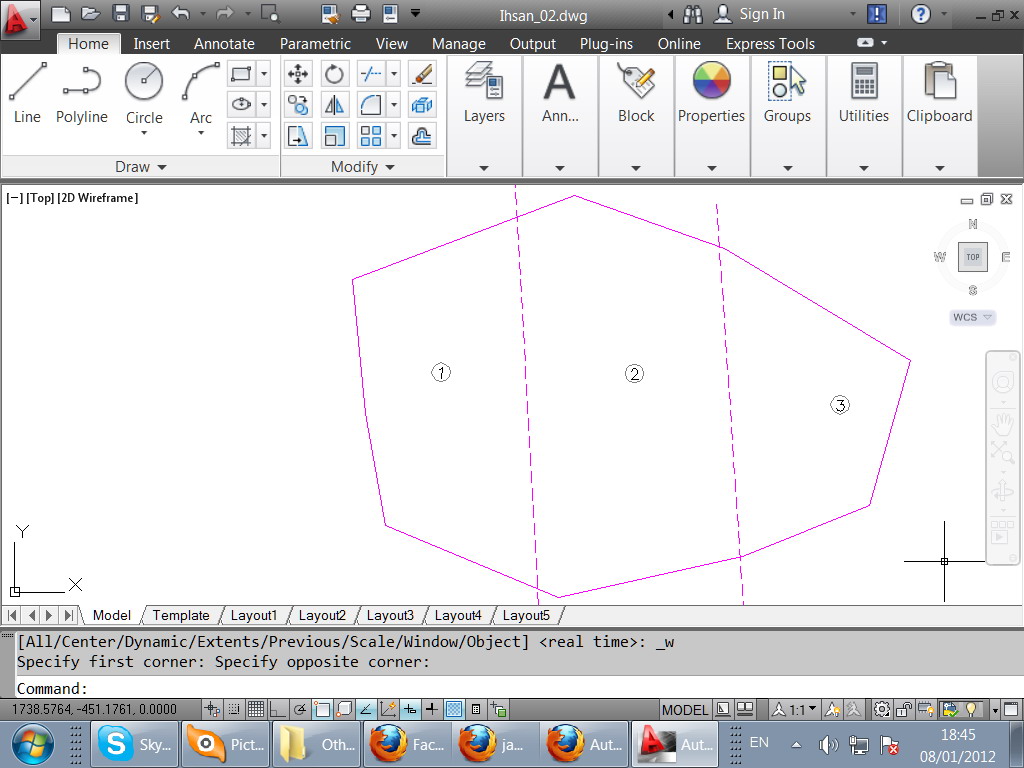

how to divide a polygon into 3 equal polygons (same area or we known area)?
I wanted to divide the polygon shown in the screenshot below into equal 3 polygons (with same area), but I couldn't figure out if these is some commands or workflow to perform this issue
is the "trial and error" is the only technique by which this issue can be done?

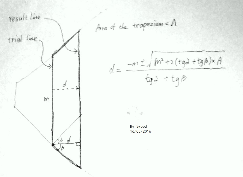

3wood
Yes but you only need 2 trials
It is just a simple calculation.
1. Get the Total area T1, then divid it by 3, get 1/3 T1=T2.
2. Try to divide the first part, get its area T3
3. Calculate the difference between T3 and T2:  |T2 - T3|= A
4. Then we need find out how much we need move the trial line (d) to make the additional area equals the area of the trapezium (A) between the trial line and the result line. Following the formula below to get d. You can easily to get the value of angle α and β in AutoCAD.
5. Repeat 1~4 to divide the rest of the polyline.
We can also make a lisp routine based on the formula below to divide a polyline into any equal parts following current Y axis direction of USC.
