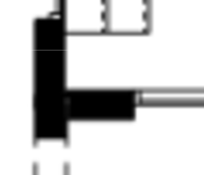

I have simply inserted an image to my AutoCAD file, but I need to be able to zoom in closely on individual pixels.  However, AutoCAD automatically blurs the pixels to smooth things out.  Can I disable this to get a more accurate reference?
This is how I want it to look
This is how it looks:

First and foremost: pixels in pictures are not zoom-able. Ever. That's the nature of raster images since the dawn of computers.
How did you get the image in AUtoCAD?
model or paperspace?
and did you scale it or not?
n8nall
the picture is inputted into the model space and it is scaled.
I don't expect to get additional information from a picture with a limited amount of pixels, but the blurring effect it does makes it look like things are different sizes than they actually are.  In applications like Photoshop, I can just zoom in and see individual pixels; it doesn't blur/clean up anything automatically.
I'm just trying to trace an image with CAD lines if that helps.

>>>...and it is scaled. ...<<<
That is a contributing problem: you are stretching those dots and making them blurry. no scaling at all may give you better results.
AutoCAD is not Photoshop: if you need Photoshop abilities, use that program (or use Illustrator for a mix of DWG/vector and Raster images), that's the better approach for quality production output.
HTH
To actually answer the question:
In command line window enter command "imagequality" and choose "draft", although this mode is only useful when zoomed in so much that individual pixels are visible.
