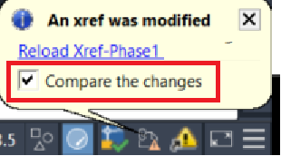

How to turn off the "Xref Compare" for good?  (i.e., so it would not appear unexpectedly).
Thanks in advance.
2,641 Views
user181
When the bubble notification pops up uncheck the Compare the changes button.
neaton
Change the system variable XCOMPAREENABLE to off if you never want to be prompted to compare xrefs.
