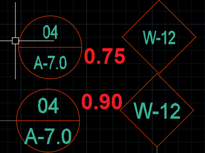

Hi, each of these tags are blocks with different names. Is there a script to run to change all of their sizes or width? They are just a little bit too big for the tags. Thanks. The file is uploaded. Thanks.

This time try this code ATTEDHTWF.lsp that reduces the Attributes Height & Width Factor by 0.75.
You can also change the 0.75 factor by changing this value in this line of the code:
 (setq factor 0.75) ; factor to reduce both Attribute height & width

The LSP worked but it overdid it. The texts are too small. I didn't understand your comment about (setq factor...) I typed it on the command line but nothing happened.

I changed the code to  (setq factor 0.9) but didn't seem to make a difference.

When you change the code you'll have to load the lisp again to activate that new setting.
Also you would have to UNDO the previous command to restore back to the original setting.
You should be able to clearly see the difference between the two as shown below:
Now I've modified the code so you'll be prompted to enter a factor #.
Give this a try.
