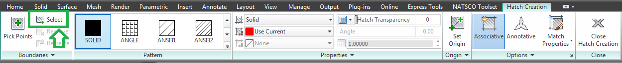

I have a drawing with many hatches. I need the area of each hatch in the drawing. I used FIELD command, it works but is slow with many hatches. Does AutoCAD have a feature to label more objects with one command?

I use Properties if I need the areas only once but sometimes I need the information many times or permanently. It would be good on the drawing or in a list if I can identify which number goes tohether which hatch.
I attached a picture about it, it is made with Field command but I have sometimes much more hatches than in this drawing.

You can try this from Lee-Mac.com
http://www.lee-mac.com/areastofield.html

ВeekeeCZ
Solución aceptada
You can try these routines. The first makes area as a field, the second as a text.
Text is placed in the middle of shape, but be careful about specific shapes such as "U" shape, where the middle point is NOT laying inside of shape.
Spoiler
