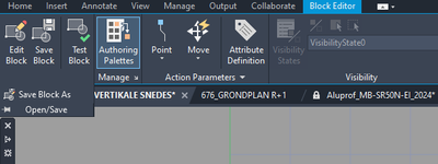

Brock_Olly
Small tip: inside the block editor there's a SAVE AS feature so you don't have to copy to a new drawing and rename the block there.
It's in the drop down menu in the open/save panel.
