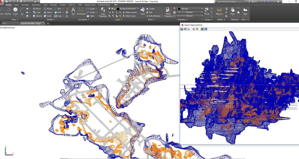

I have a wireframes (mined out tunnels underground) i need to just show the outline of these tunnels in my modelspace (similar to sketchy) but i need to have the colors as well. sketchy makes it just black. Below is what the wireframe looks like
what i need i just the outline. i t tried creating a plane through the tunnel, but thats didnt work. any suggestions ?
Kind regards
Marius

The VSCURRENT gets me the closest to a solution so far for the development tunnels. so what you see below is 1 level of a underground mine. below that is a side view of the entire mine, so at a level we want to just see the outline of the wireframes of both the development tunnels and the orebody (the big wireframe to the left of the tunnels)(the tunnels are used to get to tot orebody so they can mine it and transport the ore out via the tunnels)
I will try the subtract, but my wireframes is just 1 mesh, I will try convert to surface. if you like I can send you a small sample of the file in DWG format. right at the bottom is a image of how it should look . this is a slice of the mine. I'm not sure what package they use to get this. the tunnels are the dark bold  and the thin lines are the  ore body, just the outline
This is the result I'm after
so when I use hidden it also hides the tunnels that lie inside the orebody.
thanks for the help so far. I'm a lot closer than what I was yesterday

I think Michael is on the right track. By assigning a moderate to high level of transparency to the ore body, you'll be able to see the tunnels inside. What you might also want to do is the following:
1. Select the ore body mesh and set its transparency property medium to high (50% or more)
2. Set VSCURRENT to Realistic and choose object colors to what you want--dark gray and light gray come to mind, but it's your choice.
3. Use VISUALSTYLES to display the Visual Styles Manager, and create a new visual style that's starts with Realistic. Make it the current visual style.
4. Experiment with this new visual style--for example, set the Edge Settings to Isolines and turn on the display of Intersection Edges (to show where the tunnels intersect the ore body.
If you hate the results, delete the new visual style and create a new one based on Realistic. You'll want to leave the default visual styles unmolested so you can easily go back to a known setting.

I did a few changes to the hidden display properties to a better result. the transparency solved the problem of seeing the tunnels inside the orebody wireframe, then i also switched silhouette edges on and increased tthe width, after that i changed the crease angle till i had something workable, below is my setting for the display
here is what it looks like just after i set the clipping
and this is my final result
