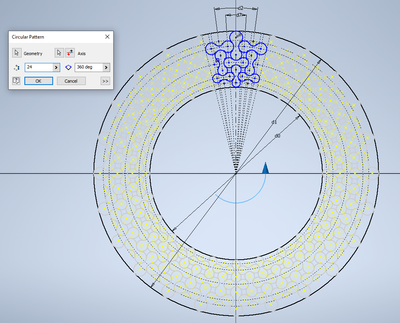

This is an interesting topic.
I have created a design based on my idea, wherein the peanut shapes are progressively scaled down from the outer perimeter towards the center in accordance with a specific rule. Consequently, I have established tangential circles with lines drawn from the center of the large circle, symmetrically arranged across the vertical axis. This configuration automatically scales down the peanut shapes towards the center of the large circle. The sole adjustment required is to modify the radius 'a' of the uppermost peanut shape, and all subsequent peanut shapes will automatically resize proportionally.

Your design is really clean! I started to just use the tangents of the circle to see if I could fit it. I like how even your cells are as well. My horizontal cells are skinnier than the vertical ones. How did you determine the scaling tangent lines?

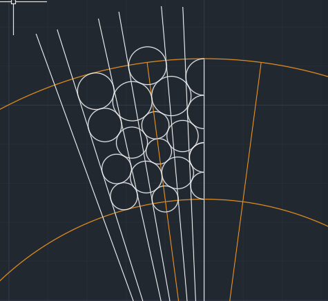

All three listed requirements (distance between arcs, the number of peanuts between, and the 15 degree) generate a conflict.  Increase the distance between arcs or narrow the angle (increase the items in the array from 24 to 27) to keep the peanut number as three.
I am done with this thread.

The two yellow lines and the vertical axis serve as primary reference lines. The two yellow lines form a 15-degree angle and are symmetrical about the vertical axis, intersecting the center of the vertical peanut shapes.
Subsequently, horizontal peanut shapes are created, and all circles are made tangential to each other using geometric constraints (see tangency symbols). The circles of the peanut shapes are then constrained to be tangential to the red and green lines.
Crucially, the tangent lines must be symmetrical about the vertical axis, and the circles must remain tangential to each other.

It is not necessary to increase the items in the array from 24 to 27. If the angle between two vertical peanut shapes is 15 degrees, then the quantity should remain at 24.

I should have responded with a little more specificity......I assumed the OP wanted the peanuts to consist of circles tangent to each other (see below).
Eliminating this assumed requirement would allow the 15 degree (or any other angle) work but the "peanut" shape would become distorted.
Retaining tangent circles (and keeping the same number of peanuts) would require a change in either the angle  or the distance between the major inner and outer arcs.
