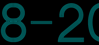

It can be in .SHP/.SHX fonts, by going to double-line [or more!] character definitions.  I've seen fonts with many more than  double passes, such as this:
which come out nice and bold and solidly-filled if the lineweight assigned for plotting is enough to close over the space between the passes.  [That one is actually called  Bold.shx.]  Hence their wanting to plug it into ROMAND, which is a Double-line font [that's what the D in the name stands for].

That's what I wanted to do, use the Roman double-line font. I'd read the vector code documentation that you had linked, and I still can't make sense of the code in the SHP file. Too many other things in there like repositioning the vector location or something like that. Anyway, I made it easier on myself for now, and decided to use the Arial Unicode MS font. I used a font editor and basically copied the data from the characters ¼, ½ and ¾ to the definitions of characters [, \ and ]. So it accomplishes what I was looking for, although not with the font I was hoping to use. Hopefully, I will be able to understand how to draw the ¾ with the vector codes.

It can be in .SHP/.SHX fonts, by going to double-line [or more!] character definitions.  .
Yes, I know. Therefore I wrote "A really bold shx-font can not be defined". If you use a small text heigt all seems to be ok. If you use a large text heigt, you see the multiple lines and not a bold char.
