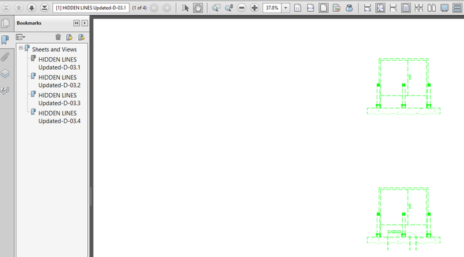

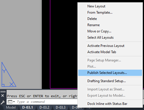

One more thing. When I selected all the Layouts, right mouse click and clicked on Publish Selected Layouts
The Publish window appears...make sure Publish in background is unchecked
Then the multipage pdf generated show hidden line on all 4 sheets (attached)
