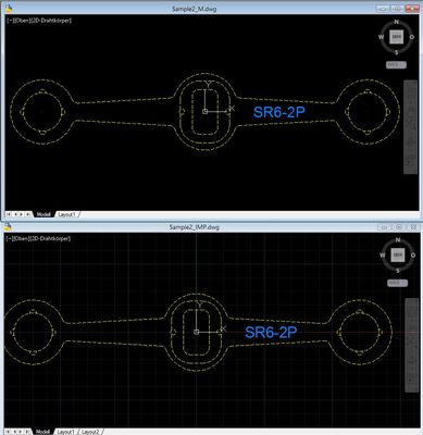

I have a block that was created in a metric template.  When I insert that block into a drawing with imperial units any arc will not display hidden.  Circles and line segments display properly but not the arcs.
All the the geometry is set to byblock. I tried changing it to hidden but that didn't help.
I tried reloading line types but that did not seem to help.
I tried various ltscales but that did not help.
Any ideas?

What is your LTSCALE set to in your destination file? 1 would be the wrong answer for your metric block in an Imperial file.

Sorry, but you uploaded an file that can be use as a blockdefinition, but not the same as you show in your picture.
Where are your "target" imperial file where the blockreference is set to linetype hidden(or hidden2) and
not displaying very well?
Sebastian

cadffm
Shut down you PC, go around the house and try it again, or take a coffee 😉
1. The outer polyline linetype is set to BYBLOCK
2. In you file where you inserted the dwg as Block: The Blockreference ltype ist set to BYLAYER
3. The Layer is NSP Spider, the ltype of this layer is set to CONTINUOUS
So, there is nothing that looks like your first images...

You uploaded the "real" data now, thanks. (next time, please let us play with the real data from start on)
But i didn't get problems.
Please test it again with your own uploaded files and perhaps try it with HQGEOM on/off
Tested with 2013 and 2019
~length 364 with metric linetypedefinition
~length 14.36 in imperial size and imperial linetypedefinition displays (as expected) the same optical result.
But again: Your (first) picture is "impossible", when it is "impossible" for usual i am searching a problem
with your graphic setting, graphic driver or card. The uploaded CAD Data is good.
Sebastian

wow, that's very weird. I just walked around to a few peoples computers and tested it. It seems to work just fine on half of the computers I checked.  Must be some obscure setting, or my autocad is corrupt.  The HQGEOM didn't help anything.
Also, if I explode the block, the lines work perfectly fine.

Turns out HQGEOM was the issue. It changed it last time and it didn't seem to work, but it works now.  Unfortunately I have to look at blurry arcs now 😞
