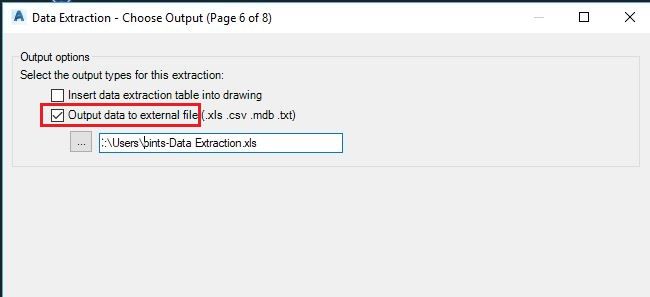

You can tabulate the coordinates in a spreadsheet.
  1. Isolate the points. If all the points are on same layer, select a point=>right-click=>select similar from shortcut menu. (When this entire data extraction operation is completed, right-click a blank area in modelspace and select 'End isolation.')
  2. Run DATAEXTRACTION  command. Go to Annotate Tab=>Tables Panel=>Dataextraction Icon. Image-1.
  3. The extraction process with consists of pages 1 thru 8 (you will skip page 7). Images 2 to 8.
  4. Open the spreadsheet. Copy all extracted data to your clipboard including the column headings on row 1. Image-9
  5. To paste the contents of the clipboard, use the TRANSPOSE option of the paste command. Image-10.
  6. In the same spreadsheet, paste the contents of the clipboard in cell D1. The cells to the right and below D1 will 'fill' automatically when you perform the paste. Image-11

You can edit your spreadsheet, e.g. add (or delete) rows or columns as needed.
