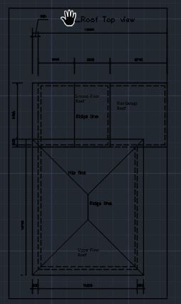

hello all
well i have this problem today after i finished my project i tried to plot it so the dash lines didn't appear as they suppose to
here is an example
any advice please iam already late with the project and now iam too confused what shall i do
and iam struggling with the font too some times i just cant make it bigger though the dimensions
and also another problem when trying to plot this Schedule to pdf  it appears like that

Message 2 of 14
SeeMSixty7
Couple of things to quickly check.
Are the lines on a layer that is set to no Plot? Check the layer manager and check the regular setting and also check it for any viewports you may be using.
Next place would be to check the plot configuration and make sure the color for those lines does in fact have a pen assignment and is not configured in a way that it plots nothing.
Good luck,
Message 3 of 14
imadHabash
Hi and Welcome to AutoDesk Forum,
regarding your first issue and IF you plot from Layout yo have to go inside the viewport and change PSLTSCLAE system variable then REGEN while you are in the VP . and the second problem check your lines layer status from LAYER MANAGER that these lines are not exist on unprintable layer like Defpoints layer.

Hi @Anonymous,
Welcome to the Autodesk Community!
As others have mentioned, you need to check to see if Paper Space Linetype scaling is turned on. Here is the Help on the command.
If you want to attach your file to a post I would be happy to take a look at it for you.

john.vellek
Hi @Anonymous,
When I reset your ltscale to 1 and kept your psltscale turned on, the linetypes show up properly in paper space.
The lighter colored lines in your table are defined that way in the Table style. If I change the style of the table to Standard everything displays properly.

Message 7 of 14
Patchy
You plot using MODEL SPACE? there isn't any .pc3 that I can see, you need to make one.

Patchy
When the plot dialog box pops up, the left one is the plotter, the right one is the pen table.
Use Properties for the left to config the paper sizes, rotation etc...
The right one, eidt it or use STANDARD that autodesk already made for you.Capture.JPG

john.vellek
Hi @Anonymous,
I am checking back to see if my post or others helped you with your problem. I see in the screenshot of your plot window, you do not have a plot style (top right) which is how you can control the color, screening, and line weights in your plotted file.
Please add a post with how you decide to proceed and your results so other Community members may benefit.

Message 13 of 14
Hi @john.vellek
thanks for your interest , and i would like to thank every one replied and tried to help me
sadly non of the previous solutions worked i made literally as every one said but no thing worked
so i made a small trick i changed the objects color to Black and i got this result :
Message 14 of 14
john.vellek
Hi @Anonymous,
I am glad that worked for you. I suggest that for the future, you do explore the plot style tables that are user defined to control all of the plot settings for color, screening and line weights. Please let me know if you need additional assistance, resources or anything else.
