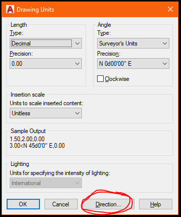

But why does it always open from the Easterly direction? Well, you will have to run your UNITS command, then open the default "Direction":
...which shows us the default Base Angle of East. (so that's where your 45's and 135's come from):
Hope that helps!
