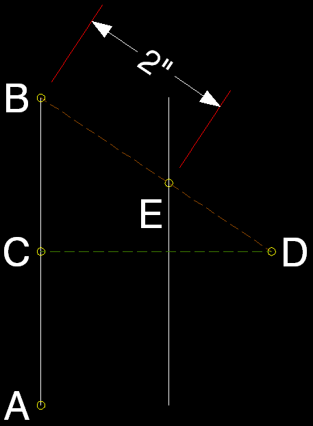

I have attached a poor quality picture of the problem I am having.  simple box, used the through command to draw a line 2" from the original.  as you can see by the measurements only one of the lines were properly drawn.  The drawing is in the same plane.  Any suggestions?

... used the through command to draw a line 2" from the original.....
 I never use that option unless there's already an obect/point that I need the offset to pass "through".  I would be interested in seeing your procedure for specifying the "through" point, but if you're just trying to offset a specific distance, just specify the distance without using "through"  (Ie overtype the word "through" with your offset distance)
I think the animation below will help clarify what's happening.  Basically it's offsetting "2" units from your pickpoint on the object "through" your cursor location using DDE  (Direct Distance Entry)  If you're going to use it like that, I recommend turning on Polar or Ortho.
I suspect you may be using the Offset command incorrectly.  [There is no "through command" -- I assume you mean the Through option in Offset.]  In this image, I drew the left vertical line from A to B.  Then I started Offset, keeping the default Through option, selected the line at C, pulled the cursor over to D for the direction I wanted to go [with Snap on so I knew it was a truly horizontal direction], and typed in 2 for the distance.  Unlike the way it works in, for example, drawing a Line, in Offset there is no rubber-band line to the cursor location from the point at which you pick an object [or from any other point].  When you try to designate the Through point in that way, it does not use a location at the distance you typed in the direction of the cursor from the selection point on the object, as it does for the next point in a Line.  [EDIT:  That may not still be true in newer versions than what I have here, as it appears from nestly2's post, but in any case their solution is the same.  I do wonder, though, whether it might work as you expect if you have Ortho on, but that would only have the desired result when Offsetting orthogonal Lines.]  It apparently uses a location at that distance and in the direction toward the cursor from the last "drawn" point [represented by "@" or (getvar 'lastpoint)], which in this situation was the end point of the Line I had just drawn [B].  It used point E [2" from B in the direction toward D] as the Through point, and of course the resulting new Line [the right one] is not 2" away from the original Line.
I was only able to discern that it worked that way because I keep blips turned on, so I could see what point it used for the Through point [it put a blip at E, as at all the little yellow circle locations], and that it wasn't where apparently you are expecting it to be in using Offset in this way.
The solution to your problem:  Just give Offset 2 as the offset distance -- don't use the Through option.
Kent Cooper, AIA
Message 16 of 18
Ok, so it truns out  to be a simple solution.  I had apparently hit F12 and turned off the Dynamic Input.  I couldn't figure it out until you said about the ortho.  Thank you all so much for the great help.  I truly appeciate it.
