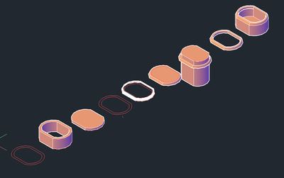

john.vellek
Hi @Anonymous,
Rather than try to edit your geometry, I started from scratch.
First I drew the outline for the base and offset in 5/8" to create the inner wall.
I then presspulled to a height matching the height of your object.
Next I used the outer outline and prespulled that to a thickness of 5/8" to create the "floor" of the object.
Next, Using sections, I grabbed the profile of the curved edge at the top of the box.
I swept this profile around the outer outline. This I exploded but retained the upper and innermost line at the top.
Next, I lofted between this retained inner outline and the outer outline.
Next I presspulled the inner outline so I could subtract it from the lofted solid.
Then I moved each place into position and used UNION to make a single solid.
I have not done the top because I am not sure what your design intent is as the shape does not match the shape of the box.
I went back in and created a closed pline profile for the lid. I then swept this along the outline at the top to create my solid lid. This is a nice, easy way to create the solid lid.
Perhaps this is enough to get you started. I have attached my version of your drawing so you can examine each of the steps.
