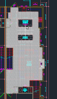

I am trying to hatch a floor plan with blocks, such as window & door blocks. The hatch preview shows a perfect hatch, which stays inside the boundaries of the room. However, when I click to create the hatch it suddenly creates a hatch that goes outside of the borders of the closed boundary.
It looks like the problems occur through the window and door blocks particularly, but I cannot tell exactly whats wrong. This floor plan has been copies and mirrored. After searching the forums for days, i have tried all of the suggested commands such as setting MIRRHATCH from 0 to 1, using REGEN before hatching, using less dense hatches and stetting other hatch command variables from 0 to 1 or 1 to 0, but nothing works.
I deleted everything off of my file except the one room i wanted to hatch, purged all unused layers, to see if my file was too big and was causing issues. I also tried using current as well as specified hatch origin. Tried using bhatch instead of hatch. No luck still.
My hatch settings have island detection checked, and island display style on "outer".
I'm lost as to why the preview shows it correctly but then when creating the hatch it blends outside boundary, says too many objects to hatch, or even no boundary found sometimes.

Hi John-
Attached is a sample file of what occurs when I try to hatch a hardwood floor pattern in the family/dining/kitchen space. It seems to select many other items outside of the closed floor plan, including other rooms like the office. Sometimes this happens when I try and even hatch one of the exterior walls.

john.vellek
Hi @Anonymous,
Thanks for the drawing file.  I ran AUDIT and it found quite a few errors. I also then ran PURGE and -PURGE>Regapps.
After that, I created a new layer state (LAS).  I see that you are familiar with this command as you already had quite a few in your file.
Then I used LayFrz to eliminate some layers from the screen to make the area selection easier for the Hatch.
I had to add a couple of temporary lines to help define the boundary for the hatch and then I was able to apply a wood pattern.
This process can be pretty quick and I hope this helps.
