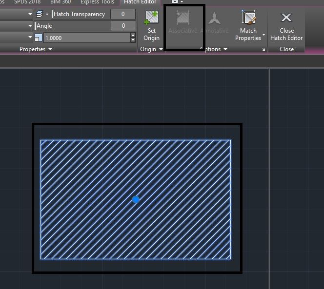

Hello All
I have a problem with hatch in Autocad2018 after install AutoCad2018 plant 3d
i can't use Associative property with hatch where when i click on it's button make it disable , and i can't edit the hatch

>> now it's doesn't with new hatches
New information or changed information? Your screenshot shows "Hatch Edit" dialog ... which means you edit an existing hatch ...
For new hatches make sure HPASSOC is set to one, then start command _HATCH and create a hatch by "pick points" or "select" object(s). Finish the hatch command, select the hatch again and look to the property window, is the hatch associative?

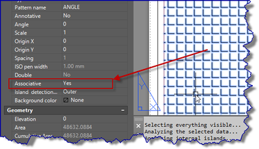

Amremad
yes iam sure HPASSOC is set to one, and associative is yes
but see this picture
Message 9 of 12
Alfred.NESWADBA
what object type is the border you selected to create the hatch?
Can you please select that border and show a screenshot with border and property window?
