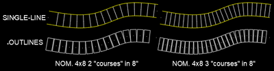

Kent1Cooper
@douglas.shortCM2W5 wrote:
.... running bond pattern bricks on a curved path. ....
This kind of thing?
Those are LINETYPES involving Shape insertions, not Hatch patterns.  The single-line versions are for smaller scales, the outline versions for larger scales where you want to see both sides of the joints.
In the single-line versions, the yellow parts would be independent objects, and only the white joint lines are the linetype.
I have them for the linetype path to be the edge, also, instead of the center as in the image.  The center versions have the little dots that don't appear in the edge versions, but if the curvature reverses like these, the edge versions get different-looking joint widths with different directions of curvature.
Are they something like what you're after?  Some possibilities:
