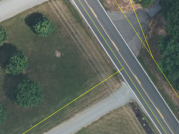

I'm having an issue with adding parcel lines on the basemap in AutoCAD 2022. The parcel layer is a DXF file projected in EPSG 2284. I'm setting the location from a point KML file that is also in EPSG 2284. Also, I select 2284 for the projection in CAD. The lines appear correctly around the reference point, but there is significant distortion a short distance away. For example, the two screenshots below show how just 1,000ft away from the reference point, features are about 10ft off from their correct location (top is CAD, bottom is from QGIS). The distances are perfectly preserved; all lines seem to measure within 1ft of the line distance in GIS, no matter how far from the reference point. Is there another projection or are there different settings I can use to prevent or significantly minimize this kind of distortion?

Pointdump
Hi Lynette,
The shadows are different on your 2 screenshots, so the CAD shot is Bing, but what is the QGIS shot?
In QGIS switch back-n-forth between Bing, Google, and ESRI imagery. You'll see the differences. I've seen Bing imagery "off" by as much as 12 Meters. So there might be nothing wrong with your linework.

l_wuensch
Thanks Dave. That did not even occur to me. I was using Google satellite originally in GIS. I added Bing aerials in GIS and they are a little different, see the pics below (top is Bing and bottom is Google). However, the difference in GIS is about 2ft, whereas the lines are off by about 8fft in that spot in the CAD file.

l_wuensch
Dave, I'm using the same Edit Location button in the ribbon as shown in the video you referenced. I used the From File option, not From Map. The file is a kml file with one point, and it is in the same state plane projection as the linework, and the CAD file. That kml is what I mean by "reference point". It works just like in the video, but my linework covers a greater area. Just a mile away from that reference point, features are about 10ft off from their location in GIS, which seems implausibly large. Also, shouldn't distortion occur with distance from the datum of the projection and not this arbitrary reference point that I am using?

l_wuensch
Hey Dave and ChicagoLooper, thanks for your helpful recommendations. I should have been more clear that I was using AutoCAD and not AutoCAD Map 3D. The lines appear in the right locations in when opened in Map 3D. It seems the spatial mismatch was due to how AutoCAD was projecting the lines on the fly.
