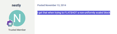

this thread has the solution:
https://www.cadtutor.net/forum/topic/54565-flatshot-operation-did-not-generate-any-geometry/

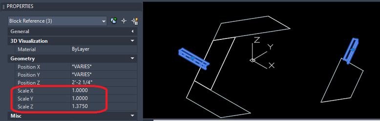

You have this block that's inserted 2x that have a Scale Z that does NOT match with Scale X & Scale Y.
Once I changed Scale Z to 1.000, then FLATSHOT worked.
