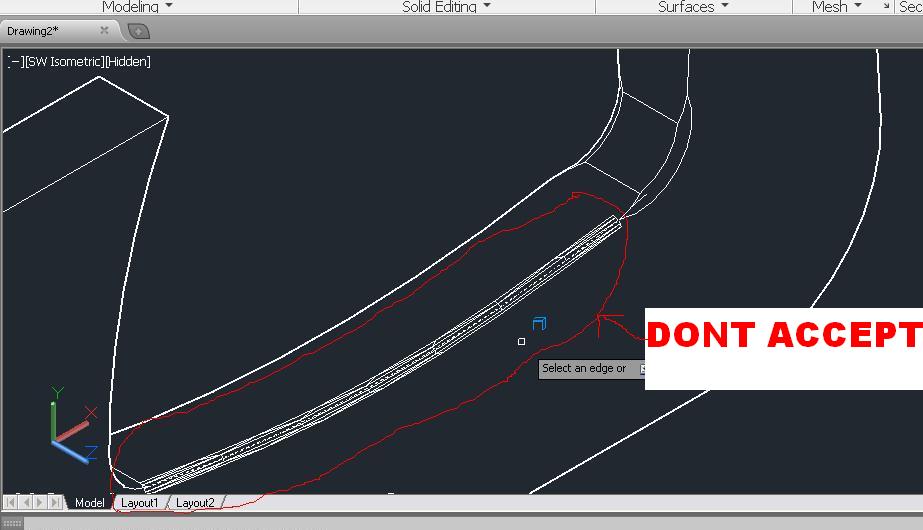

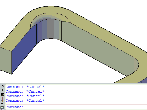

I using AutoCAD 2014 and I have a problem with Edge Fillet command. I need to round the edge of on 3D objects and Fillet Edge command works only on some edges and some will not. In the pictures you can see my example. Could that be how to solve this?

Can you attach the *.dwg file here?
Did you save the construction geometry (delobj=0)?
Do you have tangent continuous curves (the construction geometry will answer that question).
nestly2
Due to the existing fillet, there is no way to blend the selected edge.  In the instance, you'd have to use the Chain option within the FILLET (or FILLETEDGE) command to specify additional edges to blend.  More --> LINK

nestly2, I try the Chain option and I made all filet edge.
I thank you both for your help!
