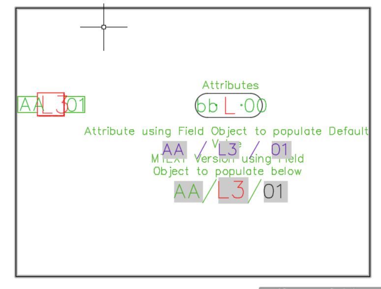

Hello fellow CADsters
Short Version
I am trying to create a block that shows a circuit reference, but this same philosophy could apply to any block reference for example Doors, Windows etc.
The 'visible' reference is made up of 3 elements;
{Location}/{Circuit Type}/{Sequential Number}
In this example, these are three separate Attributes (see below for the reason) which are on a hidden layer (or could be hidden Attributes)
There are a lot of other hidden attributes (see below)
I would like an MTEXT to show the 'visible' values of the above attributes (the emphasis on the circuit is deliberate)
e.g:
AA/L3/01
I have tried using Field Object Expressions within the block and using these in MTEXT. but they only ever display the Default Attribute Value. I have tried also making another hidden value with Field Object Expressions in - that doesn't work either and I don't think allows text formatting.
I have tried REGEN  UPDATE FIELD SAVE etc even added a Visibility State to try to trigger an update
Currently, I just have the 3 attributes set with different justification, which works but is suboptimal.
Does anyone know how to get this to work or am I going about it in completely the wrong way?
I am using AutoCAD 2012 by the way.

Hi @Graggs,
Thanks for posting your question. I'll see what I can do to assist. When I opened the file in AutoCAD 2016, This is what I see:
Can you clarify which attributes are shown correctly, and which are not?

Thank you @cheryl.buck
The text formatting makes that look rather horrible without the correct fonts... sorry!!
If you click on the right-hand block you'll notice there are 4 attributes, it's the first three we are interested in highlighted in yellow in the snip below
Presently those are correctly displayed in the lozenger
If my theory would have worked either of the two lines beneath would have updated, if the above attributes are changed.
The First line uses another Attribute to try to display the result - this is not ideal, it was just a test to see if AutoCAD treats the Field Object any differently in the Attribute.
The lowerest one is the optimal bit to get working, which is an MText string in the Block
If I can get this working, I will enclose the MTEXT string in the lozenger and hide the three individual attributes.
I hope that makes sense?
Thanks so much for looking at this for me.... good luck.

Hi @Graggs,
Haha, yes, I figured I must not have your font. I ran some tests and I also saw the fields were not updating.
I recreated the field link and it is now updating initially and when running the UPDATEFIELDS command in AutoCAD 2016.  I am pretty sure the field links worked the same in 2012 so it should not be a difference in versions.
I can see the file was originally created in Architectural Desktop 2007, so you may be seeing some results of file corruption. Maybe start with a new blank template, like the acad.dwt.
Please let me know if that helped.

Graggs
I've just tried creating it from scratch and still no luck. Would you be kind enough to share your example?
Just to check, this is what I am using for the Field Object
This is the expression
%<\AcObjProp Object(%<\_ObjId 140689266601504>%).TextString \f "%tc1">%
Thanks again for your help

matthijs_thiele
Well even if this works its a no go because autodesk uses anonymous blockid's zo the next time you redefine the block if you changed something the value would be XX-XX-XX and the field cannot link to the original object reference
