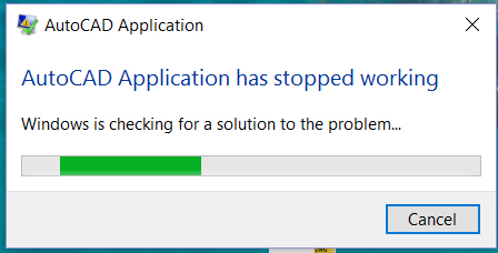

I have installed AutoCAD 2017 student version, and that all worked. However, I am unable to attach files into the AutoCAD document, so I am unable to trace the maps I need for my architecture degree work. It opens up the file finder dialogue box, but once I click on the file that I am trying to attach, the whole program crashes and I get  the following warning 'FATAL ERROR: Unhandled Access Violation Reading 0x0000 Exception at 7a8aecd00h'
Does anyone know how to resolve this issue?

This sounds a lot like the problem I have been having with 2017. Any dwg that has a pdf or image reference in it will trigger an immediate crash with the windows message 'AutoCAD application has stopped working'. It didn't happen in 2016, and I have re-installed 2017 too many times to count to try to resolve the bug. But it still happens. It was briefly fixed when I installed the update 2017.1 but then started happening again after a few days. I have also installed the update 2017.1.1, but still having the problem.
I sadly have to ask someone else to open any dwg with a pdf/image attached, unload it, and re-save in order for me to be able to open the dwg. Really wish I can get this fixed already 😕

Yeah, that article punts the issue. This happens with any PDF attached to a dwg. I've even tried with a new, totally clean empty dwg and it will still happen. Everyone else I work with has an older version of AutoCAD... 2016-2010, and they don't have the problem on the same dwg. I can open the same PDF in any pdf viewer without a problem, so it's not the PDFs.
Let's see if we can drill into this a bit...
- I always save the attachments with a relative path (but full path will still trigger the crash).
- Most PDFs are scaled up a lot (frequently 96x) and rotated in the dwg, and sent to the back of the draw order.
- PDFFRAME is typically set to 2.
- Some have a transparency or fade, but some don't.
- for compatibility with the other people I work with, my 2017 is defaulted to save files in 2010 format.
Attached is a screen grab of some of my file/save settings that might be helpful.
I also just created a blank new dwg and attached a typical pdf containing a scanned sketch that I would then pass on to a drafter. This dwg file crashes my AutoCAD every time I open it...
(to clarify, I can usually attach the pdf or raster image, adjust it, an see it in my file just fine - this only happens when I try to open the file with the PDF attachment already in it)
