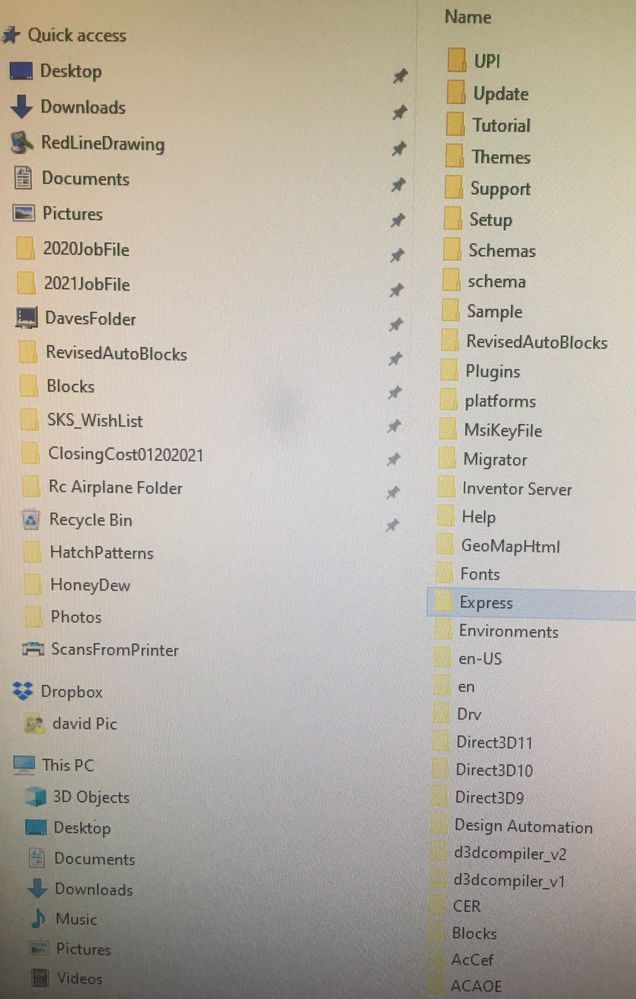

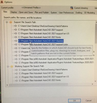

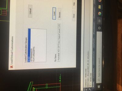

I have Just Up Graded to AutoCad 2021, and The Express Tool Pull Down Tab is not Showing along
the Top Ribbon.
I have Gone Down and Tried all the prior Posts on the Same Issue, all with Negative Results.
I have Taken Screen Shots of All the Procedures I have Performed, Maybe there is Another
Avenue we can Pursue.

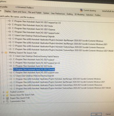

Just install or reinstall Express Tools, looks like you are using a migration when you upgraded instead, here is how https://knowledge.autodesk.com/support/autocad/learn-explore/caas/sfdcarticles/sfdcarticles/How-to-i...
daveshepherd
Thought we had it, but unfortunately it didn't appear on Upper Ribbon
Attached is the Screen Shot.
