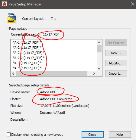

- When plotting our section uses "Adobe PDF". (not one of AutoCAD's defaults: "DWG to PDF", "AutoCAD PDF (High Quality Print)", etc...)
When using EXPORTPDF, AutoCAD is not using the "Current" page setup. How can this be fixed? Am I missing a system variable or something? I start here...

...here is my current page setup for all layout sheets...
page setup for "Adobe PDF"page setup for "Adobe PDF"
Just one sentence to that which might help to understand this. What should AutoCAD do when you want to create a PDF but in the page-setup a plotter like "Epson" is defined? So as every layout may have a different output device the EXPORTPDF command needs to overwrite/modify the page-setup.

I already have a .pc3 file in that location. Why does yours show on your PDF Preset dropdown list and mine does not?

While I understand that overrides are definitely a necessity, this would not explain why AutoCAD would provide the "Page Setup: Current" option if it's going to automatically override them every time?
