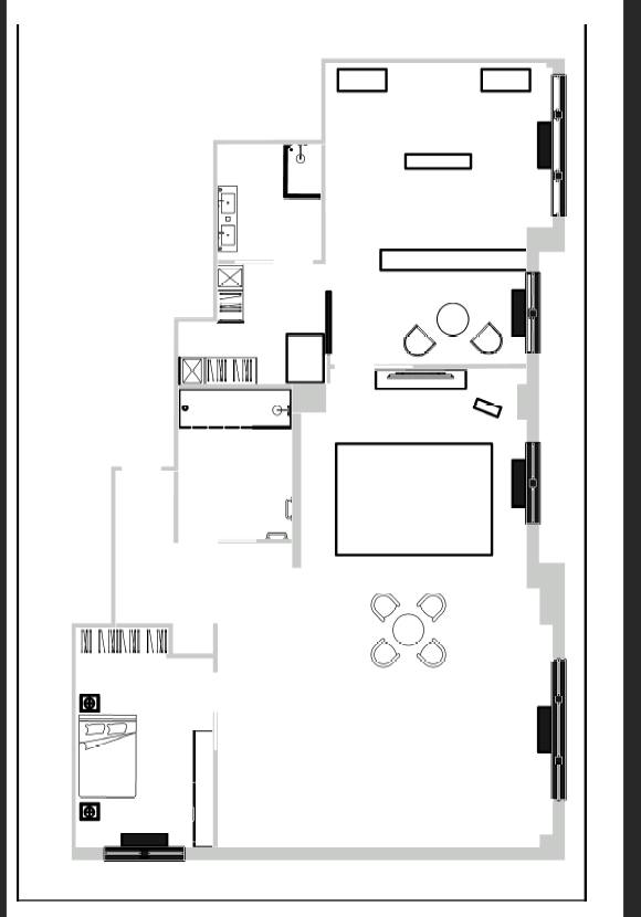

Im trying to export my DWG file to PDF but a lot of lines are missing. Im still learning the AutoCAD program ive tried experimenting with the setting but cant get it right at all. Im attaching a screenshot of the plan in AutoCAD and what the export looks like.
Any and all help is VERY appreciated.

Would you mind uploading the dwg file?
Are you exporting from Model Space or Paper Space (layouts + viewports)?
There are many possible causes, i.e.:
  • Freezed layers.
  • No plottable layers.
  • Elements or layers with 255 color.
  • Plot Style Table misconfigurations.

Hi, Im I tried exporting from both

As @fatal.error  asked above - without seeing your dwg it's a poke in the fog for us  😞
