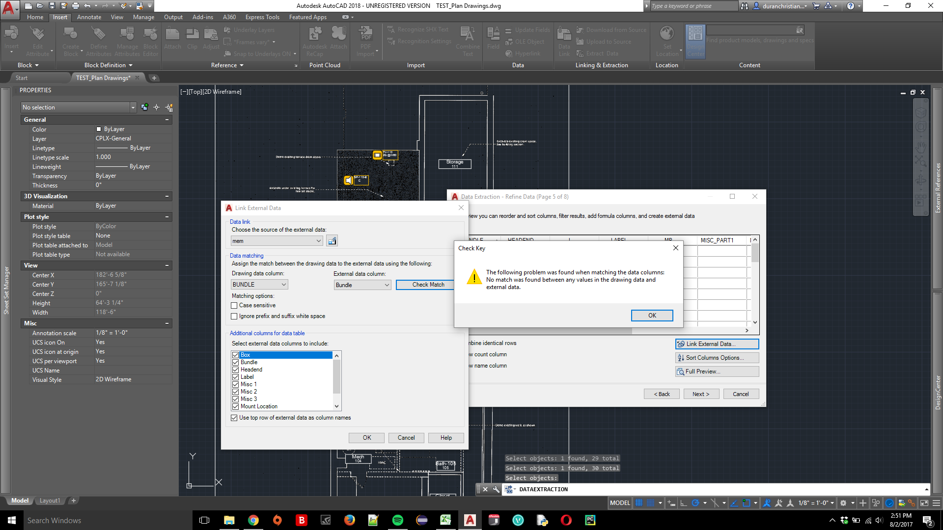

Thank you for the welcome! Unfortunately I don't have enough time to make an example file so I'll show you what I have for now. I used dataextraction to make a table that was identical to the table I created in excel that only included attributes of blocks in my drawing. I attempted to link the two tables but was met with the problem of a unique item not being in my excel spreadsheet. I found an image of the problem that arose and linked it below. All items listed in both the Excel spreadsheet and the Autocad table are identical so I don't know what the issue is there. I then made a table directly from the Excel via datalink. I found that I could edit the contents of the Autocad table and "upload user changes to source file" in the data links section of the right click menu when selecting a cell in the Autocad table. However, as you can see in the image below, 0 changes were made to the source file.
Message 7 of 18
@john.vellek I feel as though linking the source file to the dataextraction table is the easiest but, even if I use an empty spreadsheet, Autocad states that there are no matches between any of the values. And when I do use the other spreadsheet that's populated with the same information it says there's nothing unique. Not really sure what I should do.

I will try to make a video of the process for you but here are the steps I have taken in the past.
  • Open the drawing file and run a DataExtraction
  • Write the data out to an Excel file (don't create the data link yet)
  • Next, open the Excel file and check all the column headings to make sure they are clean
  • Save the Excel file with a XLSX extension and close the file.
  • Run the same data extraction but this time link to the external file.
  • When prompted to match column names select only ONE - this acts like a database index.
  • Now when you complete the extraction it should link the data to the spreadsheet.
John Vellek
